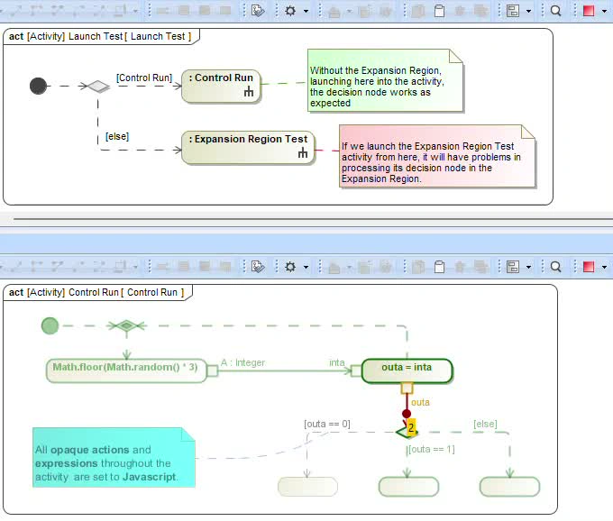

Here is an odd problem I encountered when making an Activity to demonstrate a few things. I wanted to assemble an array of integers in one Action and deal with its members one-by-one in another part of the Activity. This is the sort of thing Expansion Regions are for.
It seems that when you launch one Activity via another Activity, then Decision Nodes inside Expansion Regions misbehave. (There are all kinds of reasons you might want to do this in a non-trivial system.)
The problem manifests as follows: the Decision Node in the Expansion Region chooses its exit Activity Edge programmatically via a script expression in the edge's Guard, but when the containing Activity is invoked by another Activity, the Decision Node ignores the Guard's script and posts a yes/no dialog with the text of the script instead. If the Activity is launched (simulation) directly, everything works as expected. If the Decision Node and its related Actions are extracted from the Expansion Region (and it's fed individual integers), then the logic works as expected.

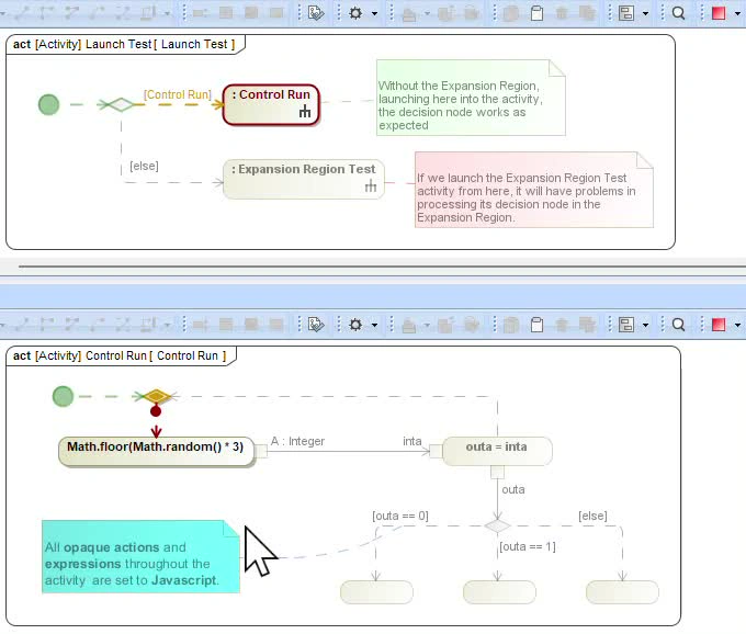

  1. Works: The decision logic, launched directly (illustrates just the programmatic Decision Node)
  2. Works: The decision logic, launched indirectly

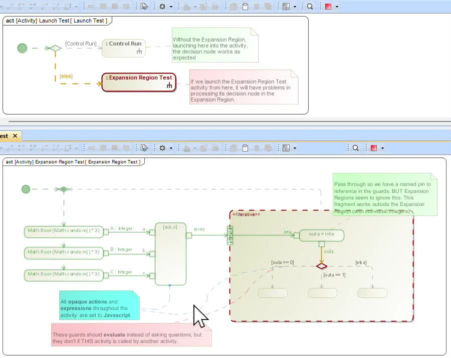

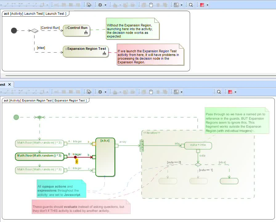

  3. Works: The decision logic within an Expansion Region, launched directly (illustrates intended operation)
  4. Fails: The decision logic within an Expansion Region, launched indirectly (what I originally wanted to demonstrate)

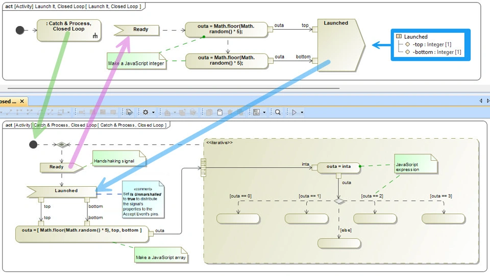

My original model was more interesting. You can see it in the "More Interesting Model" graphic. 🙂
