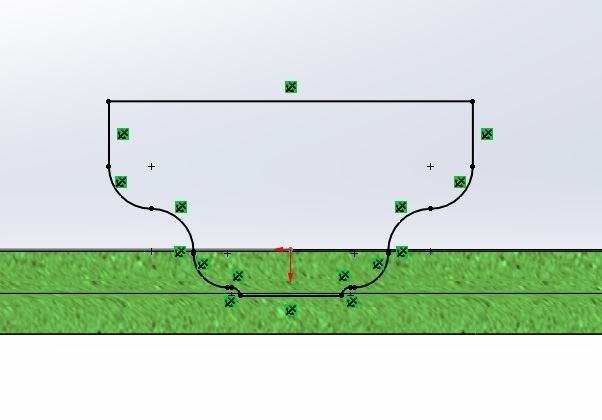

This results in self intersecting geometry if i use the full profile. i really can't edit the profile every time since this is taking too long.
Example profile

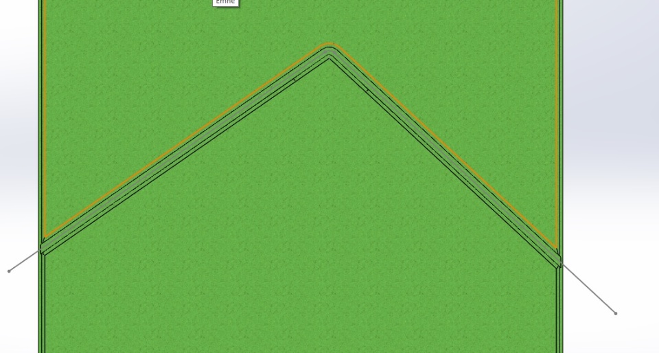

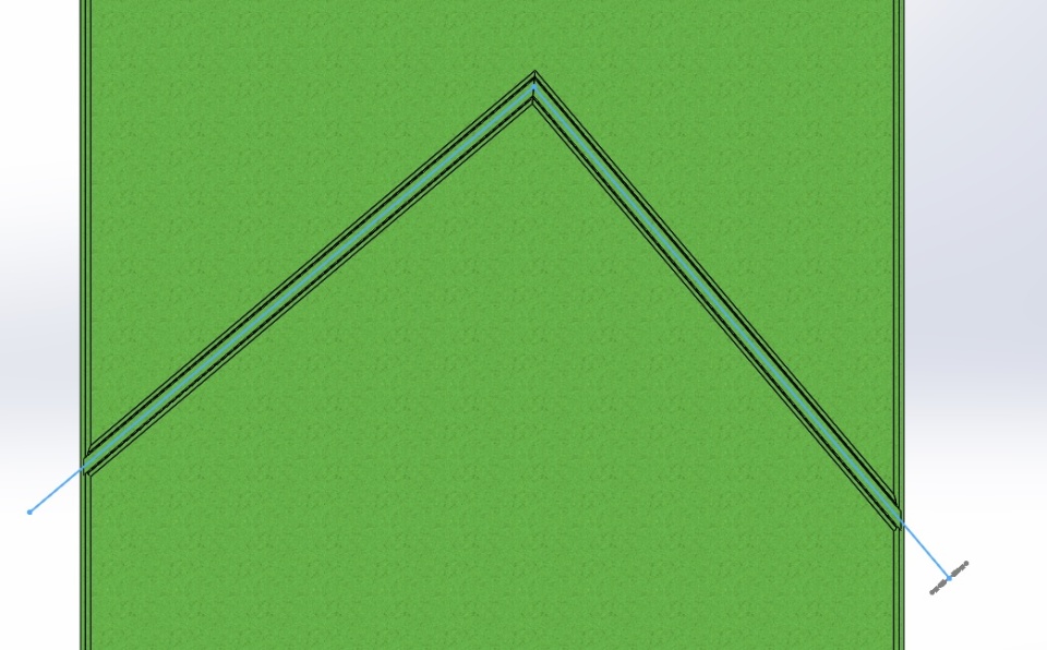

With stright path corners (not optional since this creates strigth cut corners.

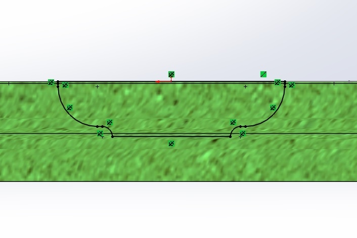

Prefered results! (Here i have modified the profile to only the used part, also corners of path match profile radius.)
Edited profile to only used part.
