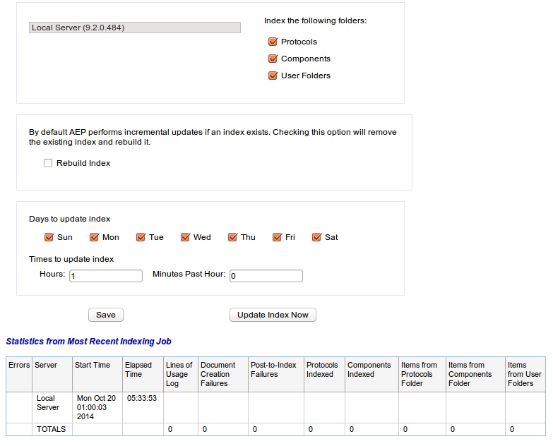

On one of our AEP9.2 servers on RHEL 6.5 the XMLDB indexing is not working. It's configured to run daily at 1am, and I can confirm that it does. However, the index produced is empty - searching it turns up hits from the installed collections but nothing from protocols/components created locally.
I've tried rebuilding the index from scratch several times but this has made no difference. I've also deleted the contents of the _PP_ServiceAccount before running the rebuild but this hasn't helped.
Can anyone suggest how to get the indexing working.
