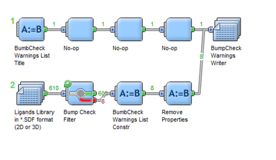

I'm processing an *.sdf file and I want some data to write as a plain text file but in a way that for each data column in the text file I want a column name(s) as a first line (see below). A already achieved this in two steps (see attached picture):
1. Constructed the title (Custom Manipulator) that is connected directly to the TextWriter component.
2. Processing *.sdf, formating needed data (Custom Manipulator) and writing the data to the same Text Writer component.
If I do the same in a single pipeline, expectedly the title line will be written as many times as the number of structures filtered. Is there an elegant way to construct the titles just after the Bump Check component and to write just once in the text file, since if everything go on the green port, there is not needed to write the data?
Thanks,
Nikola
