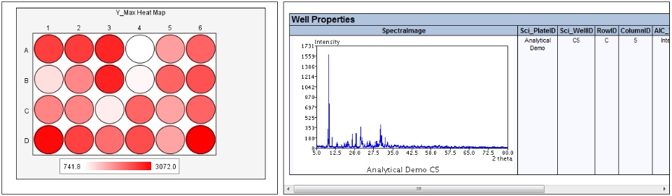

Purpose: Enhanced version of the released Plate Viewer (Interactive) component allowing the user to see spectra, not only molecules, in the Plate Information Well Properties Container.

  • The last one, Plate Spectrum Viewer (Interactive) Example is an example protocol, save/run it anywhere, but it is web services folder enabled. It shows how to use that with example data provided within the collection
