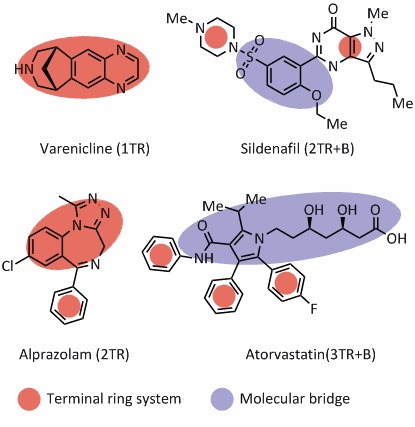

In two recent papers [1, 2] from AstraZeneca, two metrics were calculated and correlated with promiscuity. The percent of a compound represented by the Bemis-Murcko framework was calculated in Pipeline Pilot; however, the authors used the OEChem toolkit to calculate a topology class (RSC: ring system complexity) based on number of terminal rings and presence of a molecular bridge. There could be a speed consideration for using OEChem (the calculation was implemented in C++), but I was wondering if it could be prototyped in Pipeline Pilot either with the molecular toolkit or standard components (which may be accessible to a broader range of users). I've an implementation that I think does the same thing [3, 4], but it’d be interesting to see what others would come up with.
Your challenge: reproduce the RSC descriptor in Pipeline Pilot. The RSC descriptor is of the form xTR[+B], where x is the number of terminal ring systems in the Bemis-Murcko framework, and the +B is added if those rings are connected with any atoms at all (it appears the maximum value of x for which there are cases where +B is not added is 2, as there is no way to connect 3 or more terminal rings without connecting atoms). Unfortunately, I can't offer a prize other than the glory you'll receive posting your protocol here :-)
For added challenge, the second paper [2] expands the descriptor to xTR[+B_y] where y is the number of ring systems remaining once all terminal ring systems have been removed from the Bemis-Murcko framework. (I'm still thinking about how to do this in Pipeline Pilot.)
