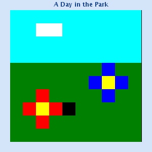

Introducing the Pipeline Pilot Animation Studio, an all-in-one component (sort of) that allows you to craft stunning animations (sort of) with your favorite Scientific Pipelining tool. To use the PPAS, all you have to do is “paint” the frames of your animation using a two-dimensional array. Each array will then be rendered into an image and all resulting images will be merged into an animated GIF for display in your report. The PPAS gives you the ultimate control by allowing you to carefully (tediously) specify the color for each pixel in your image.

Taking the "Frame Creation" out of the Studio definitely makes it more flexible. What I'm doing now is just saving the images in the Studio such that you can send in your Canvas or Chart data records to be animated. It probably takes a little bit longer now because there is an extra RTC subprotocol, but I think it will be minimal. PipelinePilotAnimationStudio_2 has the new Animation Studio component and produces the same animation as before.
Regarding the Asteroids, animation, there definitely is something off about the ImageMagick convert version. What I found is that if the Canvas is all black and white, it gets saved as a grayscale image with a PixelType of "unsigned char". If, however, you add a bit of color, it gets saved as an image with a PixelType of "color" and this seems to animate no problem. In the attached "Asteroids 3" protocol (also modified for the new Studio), I changed the color of the "PLAYER 1       HI-SCORE        PLAYER 2" line to be an off-white (#FFFEFF) and this was enough to fix it. If a different version of ImageMagick is what fixed it, then I assume there's something wrong with this version as opposed to something being wrong with the PNG Writer.
I haven't had a problem with lots of frames and did an animation with 1000 frames without issue (see below). I use the format() function to left-pad the filename with 5 zeroes, so unless you're doing 100,000 frames, you should be ok. Let me know if you continue to have problems with this with the new component.
