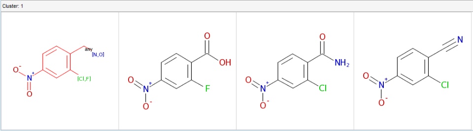

Purpose: This example workflow with the included component "Generate Fuzzy MCS" is to introduce fuzziness into Maximum Common Substructures, i.e. for similarity-based clusters, and to propose a solution for automated generation of fuzzy MCS's. By that, much more flexibility in defining descriptive scaffold structures is provided for clusters whose intrinsic structural diversity is too high to be characterized by conventional Maximum Common Substructure approaches. Flexibility is introduced by standard query features so that the resulting "fuzzy" substructures are still fully database-searchable.
Supported query features are:
  • Element lists for atoms, e.g. [C,N,O]
  • Single/double or Any bonds
The screenplay of the current approach is like that:
  • Set all atoms and bonds to "any"
  • Generate a conventional MCS
  • With this "Any-MCS", do a substructure search against the cluster molecules
  • Reduce the cluster molecule structures to the found substructures
  • Repeat substructure search against these reduced structures to standardize the mapping of query to reference atom/bond indices
  • Go through the atom/bond index lists of the reduced references and store all index-to-type correlations into lookup tables
  • Remove redundant information from these lookup tables
  • Now take the "Any-MCS" and replace the atom/bond types by the look-up table content:
    •     if there is only one feature remaining for an atom/bond in the look-up table: Assign it directly
    •     if there are >=2 features remaining: Assign query features
  • Kekulize the result structure to solve remaining mesomeric structure issues
