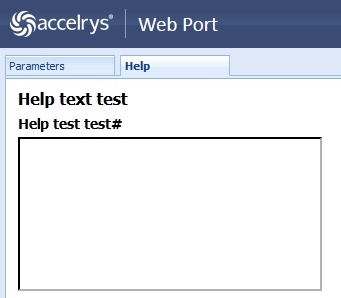

And although it worked for the text within the Pro client, it just showed an empty frame in the webport (see attached).
