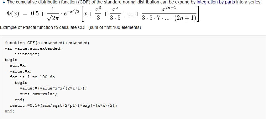

Pipeline Pilot does not have a built-in cumulative distribution function but I found the below procedure to calculate it on Wikipedia (https://en.wikipedia.org/wiki/Normal_distribution#Cumulative_distribution):
The Pascal code is easily translated into Pilotscript but how many iterations are needed? I tried a few numbers in the script below

Now finally my question. The correct value according to http://www.solvemymath.com/online_math_calculator/statistics/cdf_calculator.php is
0.8413447460685429
0.84134475
The pilotscript calculated value starts to diverge after the 6th digit. In the application I have in mind the value of the 7th digit is irrelevant but still this is strange. I am not losing sleep but if anyone can tell me what went wrong that would be appreciated.
