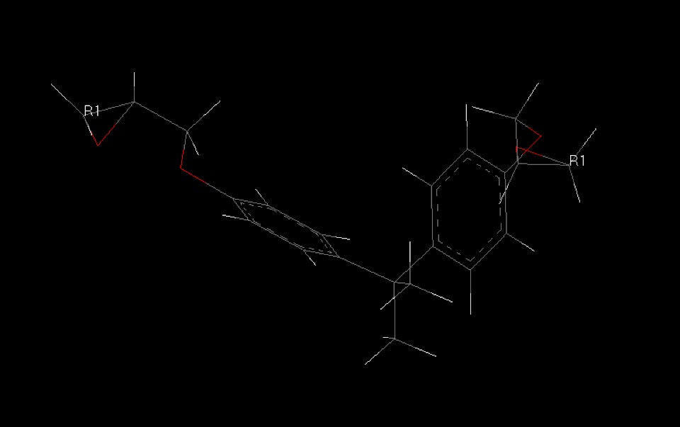

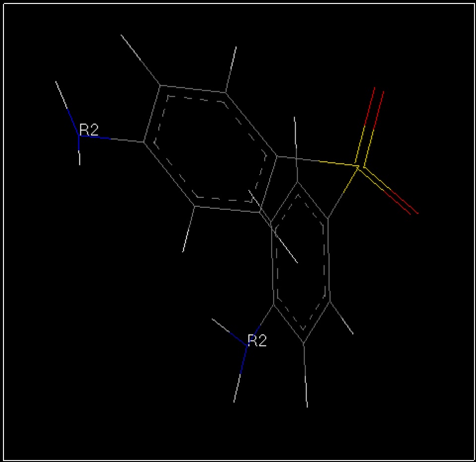

I am trying to run the Create Polymer Network Pipeline Pilot protocol using DGEBA and 4,4' DDS as the epoxide and the linker. I have defined the labels R1 and R2 as the reactant sites for DGEBA and 4,4' DDS respectively. I have also altered the Create Polymer Network Protocol as suggested earlier to turn Restrain Rings in the Create Amorphous Cell to True. With these settings, I can sometimes successfully crosslink a structure, but other times the system fails with an error. I have included the Summary.html showing the input as well as the Error.txt file below for reference. Any ideas as to what might be going on? Note that the error happens (or not) regardless of the loading. Note I have also included stick figures of the precursors attached below the text.
I would love to be able to see the code that gives rise to the error (main::RingOpening(Cfx::COM=HASH(0xd12dcf8), Cfx::COM=HASH(0x7756560)) called at (eval 10) line 32), but I don't know how to access the code within Pipeline Pilot. Any suggestions as to what to try to improve reproducibility?
Protocol failed: | Error executing parallel subprotocol on crater.a04.aist.go.jp: 'Unable to find bond to delete |
