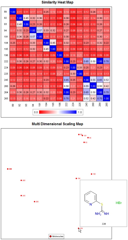

Purpose: This example reports a similarity heat map and a MDS map of molecules. Made after a user's request after that other protocol
* Calculates a similarity measure for each input molecule with each of the other input molecule
* Creates a Heat Map plot of the similarity matrix
* Performs multidimensional scaling (MDS) analysis using R and displays the molecule in a XY Chart that allows you to see them with a tooltip and select one
