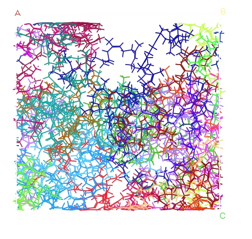

I am modeling the nature rubber and I use the Materials Studio 5.0 to built the rubber system. However, when I want to built the confined model of the rubber, the job is always failed (see the attachment). Is there anything wrong with me method?
1) I use the c_isoprene in the lib to generate a polymer chain in Homopolymer part.
2) I use the generated chain to build the polymer structure in amorphous cell.
Below is the .out file for this job.

Error: Dynamics: Energy difference between successive steps in dynamics is greater than the user defined variable DEVIATION, 5000.000
invoked from within
"dynamics time = 2000 timestep = 1.0 initial_temperature = 298.00 +boltzmann ensemble = NVT temperature_control_method = velocity_scaling integrati ..."
