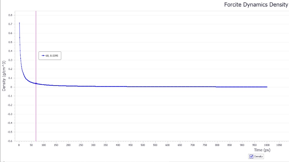

Dear all,
I'm attempting to obtain the water density at 1 bar. To do so I ran NVT:

Followed by a NPT:

In the case of NPT I picked 0.0001 GPa (= 1atm), nonetheless the simulation cell is growing in size giving a density of neanrly zero at the end of 1 ns run. The expected density is 1 g/cm3 at 1 atm. Please take a look at the attached density as well as cell dimesion profiles.
Could you give some comments on the finest and optimum parameters/settings for these runs?
