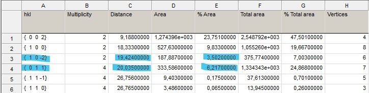

Hello everyone,
I calculated a BFDH morphology with Morphology Module from benzoic acid unit cell. I obtained a nice result, but I don't understand some values in the table (cf. blue value in the table below ). Why the %Area of (0 1 1) is more important than (1 0 -2)?
I have a similar inversion for a growth morphology for another molecule. An explanation will help me greatly.
