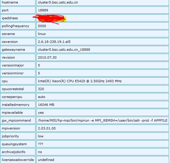

The problems about the activate the queuing system!
The PBS is installed in my cluster,and my cluster is installed CentOS ,which is linux.
When I finish the installing MS  in my cluster.
And  the corresponding index is :
/public/home/msi/MSI55/etc/Gateway/config
config/configure queue -queuepath [-activate]
and in PBS ,I don't know the right order.So I follow the LSF ,and using order as follows :
./configure queue -queuepath PBS/dsd_pbs -activate
And the screen shows as follows :
---------- Queue name =  ???
Queue configuration complete
But when I subject works to the comper with the gateway.The error always appears :
Queuing error: qsub: Unknown resource type  Resource_List.place
Job failed during launch process, no results generated, no  results downloaded, and project results folder has been  removed.
And when I type the ip:18888,and gointo the web page.
The web page is as follows :
Wat's the matter?
Any suggestions ???
And in the
/home/MSI/Accelrys/MaterialsStudio55/etc/Gateway/root_default/dsd/jobs/OXUK5/stdouterr.txt    ,shows the word as follows:
mpirun: /user/bin/ssh: Command not found
