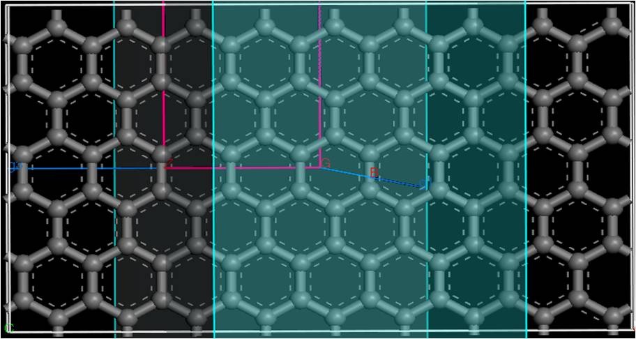

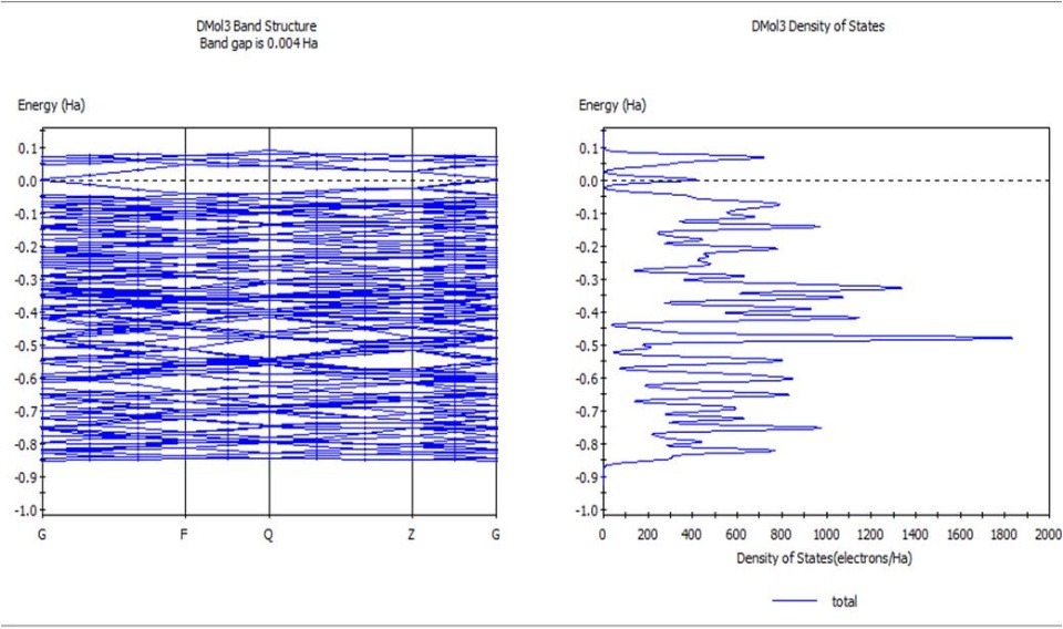

I want to ask you guys for graphene band gap
In experiements, it was found that the band gap of graphene monolayer is 0.
Is it possible to get the zero band gap of graphene theoretically??
In my calculations, the band gap was not zero...
Somebody has a experience for pure graphene band gap calculations. Let me know you guys opinions
I wrote my detailed calculation conditions and attached the figures for DOS and Band Structure
Best wishes
