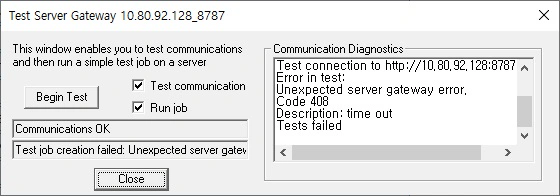

I am writing to inquire about an issue that has arisen with job submission through the gateway following the reboot of our Linux cluster. Although the gateway that was previously in use is running correctly, when I tested the gateway from Windows, the following error message was displayed as shown in the picture below.
However, when connected via SSH, it appears to run without any issues, which leads me to suspect there might be a problem with the Apache server. When I checked with `systemctl status apache`, it showed that the Apache server was up, but the Apache server error log displayed the following message.
[Mon Sep 02 13:24:39.131997 2024] [mpm_event:notice] [pid 293163:tid 22726645680000] AH00489: Apache/2.4.57 (Unix) mod_perl/2.0.12 Perl/v5.36.3 configured -- resuming normal operations
[Mon Sep 02 13:24:39.132047 2024] [core:notice] [pid 293163:tid 22726645680000] AH00094: Command line: '/home/biovia/MS/MaterialsStudio24.1/Apache/bin/httpd -d /home/biovia/MS/MaterialsStudio24.1 -f /home/biovia/MS/MaterialsStudio24.1/etc/Gateway/configurations/default/conf/httpd.conf'
[Mon Sep 02 13:26:12.309720 2024] [mpm_event:notice] [pid 293163:tid 22726645680000] AH00491: caught SIGTERM, shutting down
[Mon Sep 02 13:28:44.364041 2024] [mpm_event:notice] [pid 293475:tid 22920591755136] AH00489: Apache/2.4.57 (Unix) mod_perl/2.0.12 Perl/v5.36.3 configured -- resuming normal operations
[Mon Sep 02 13:28:44.364093 2024] [core:notice] [pid 293475:tid 22920591755136] AH00094: Command line: '/home/biovia/MS/MaterialsStudio24.1/Apache/bin/httpd -d /home/biovia/MS/MaterialsStudio24.1 -f /home/biovia/MS/MaterialsStudio24.1/etc/Gateway/configurations/default/conf/httpd.conf'
./httpd: symbol lookup error: ./httpd: undefined symbol: apr_thread_mutex_timedlock
Is there a way to accurately determine what the problem is?
