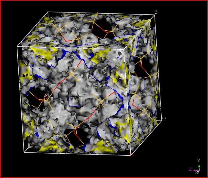

Hello everyone,
I intend to calculate the electrostatic potential of periodic structures (more precisely, zeolites) using DMol3. I successfully performed such calculations some time ago, running Materials Studio 4.X under Windows XP. Now, I am using Materials Studio 5.5 under Windows Vista. Unfortunately, the calculation delivers very strange results, with a very "edgy" ESP with many kinks and local oscillations (see attached picture). The older calculations gave much smoother results which looked more reasonable.
I have attached the input below. The structure is the SOD zeolite from the provided structures, replacing all Al atoms with Si for charge neutrality.
Does anybody have any hints where this problem comes from? Is it related to the operating system?
Best regards,
Michael
DMol3 input:
