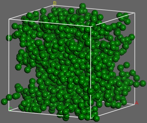

Simulations are performed using the MARTINI force field.
Frist, 300 polyethylene oxide (PEO) molecules are randomly positioned in an initial periodic box of size 51 angstroms/size.

The initial box and force field files are in the annex.
I need some assistance.
