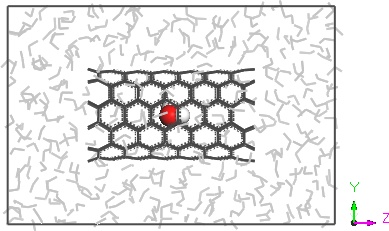

Attached is a script to calculate the local diffusivity with Forcite using the method above. The input consists of a 3D periodic structure, with a set named "Probe", containing one molecule at the position (and orientation) of interest. The script will fix the molecule, and run a molecular dynamics simulation outputting a trajectory. Since Forcite does not write out force data of fixed atoms, a copy of the trajectory is made in which the constraint is undone. An additional energy calculation on this trajectory provides the forces. Finally the force is time correlated, and integrated, and the diffusivity is output in a study table, for X, Y, and Z direction separately.

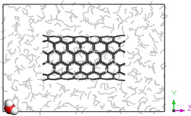

As a test I applied the script to an open-ended (and fixed) nanotube immersed in water. I calculated the diffusivity of water inside and outside the nanotube. Below are some results (in Ų/ps). By comparison, the diffusion coefficient of water from mean square displacement analysis in this system gave 0.195 Ų/ps.
