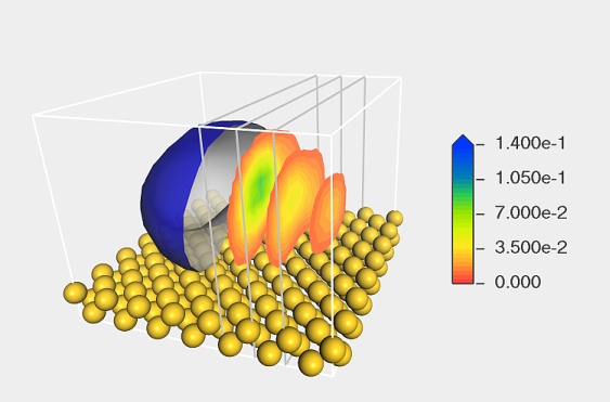

Below is an application to polystyrene chain grafted on a gold surface. The analysis applies to the repeat unit at the end of the chain.
| Input |
| Output |
