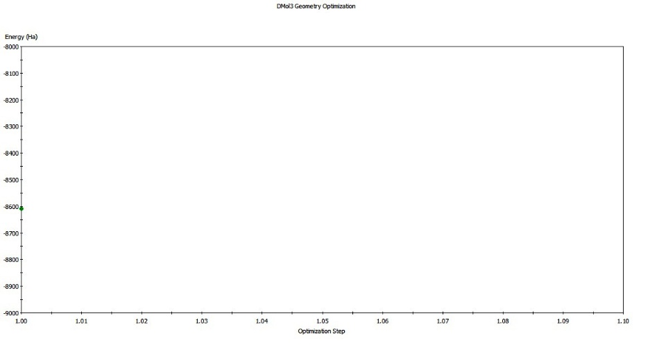

I am trying to calculate "Geometry optimization" along Frequency (ZPE) by Dmol3 for NiO and CuO. But there is an error. The error is mentioned in the following:
Message: SCF not converging. Choose larger smearing value in DMol3 SCF panel
or modify/delete "Occupation  Thermal" in the input file.
You may also need to change spin or use symmetry.
Resubmit DMol3.
Message: DMol3 job failed
Error: DMol3 exiting

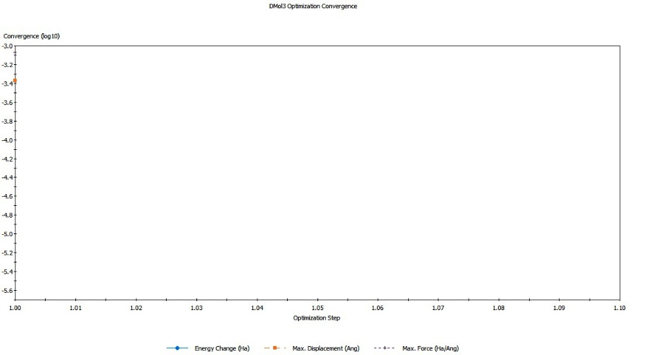

And also as you can see from following images, convergence and energies figures are empty. Just there are 2 yellow and green points on the y axis.
After that I did some changes in input files, such as;
  • Increased the SCF convergence requirement to 1e-4 (from 1e-5)
  • Increased the max number of SCF cycles to 1000 (from 50)
  • Increased the DIIS size to 10 (from 6)
  • Enabled and increased smearing (at 0.08 Ha)
  • I changed spin and also I used symmetry
I would appreciate any help in resolving this matter.Thanks
