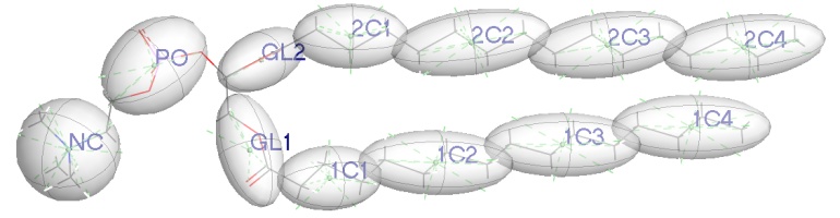

The DPPC lipid was coarse-grained and fine-grained using the standard approach defined in the first MARTINI paper by Marrink et al. To create this, we initially defined centroids on each group of atoms representing a bead and then created the motion groups. The name of the motion group and centroid for each “bead” of atoms needs to match and but each “bead” of atoms needs a unique name. For example, see the structure below where each motion group is labelled by its name.
