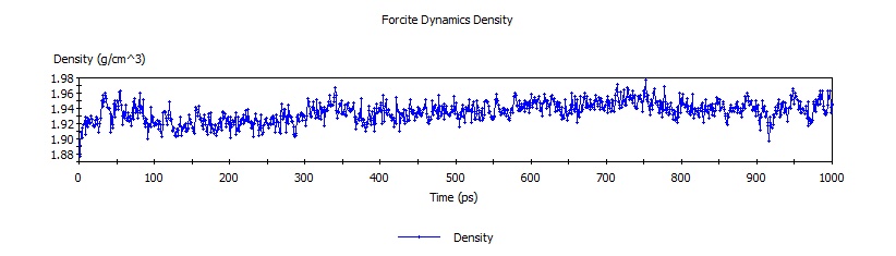

Hi,
I've constructed a model of a random co-polymer with a single chain of 400 repeat units and packed the chain into a periodic box with Amorphous cell at low density, i.e. below the experimental density. The low density is to prevent ring spearing and catenation as the repeat units contain cyclic ring structures. I then performed a series of dynamics and geometry optimization steps with Forcite using the COMPASS forcefield in order to relax the structure, and then using NPT dynamics slowly compressed the model to above the experimental density of the polymer. I then annealed the structure using the annealing dynamics option, after which I attempted to relax the structure to close to its experimental density using NPT dynamics with a set pressure of 1 bar (0.0001 GPa). After 500 ps with a time step of 0.5 fs however, the density was about 1.84 g/cm3, where the experimental density is reported as 1.74 g/cm3. Thus the density is stil a bit high. I then tried to anneal the structure again and to repeat the NPT relaxation step again using 1000 ps simulation time and a time step of 1 fs. The resulting density as a function of simulation time is shown in the picture, where this time it increased again to about 1.94 g/cm3. I am using the Berendsen barostat and Andersen Thermostat for the NPT runs and have noticed that the pressure is not acurately reproduced at 0.0001GPa. Is this because this level of accuracy is not achieveable?
Does anyone have any ideas as to what I can try to get closer to the experimental density?

Hi,
I since used NPT dynamics at 0 GpA and a higher temperature of 600 K to expand the system again so that the density decreases to about 1.6 g/cm3, where after I decreased the temperature to 300 K again (increasing the density again), which seemed to help a bit, althoug the difference between the resulting density and reported experimental density is still at best about 2%. Does anyone have any ideas as to what I can do to get closer to the experimental density?
Also please can someone help me with the problem mentioned above regarding accurate control of the pressure when running NPT dynamics? I want to run NPT dynamics at 1 bar (0.0001 GPa) but the barostat (Berendsen) does not seem to accurately control this.

Hi,
Since your polymer has rings you may want to double check there are no spearings, since these would prevent the system from expanding. There is a script to help with that: .
Your polymer is quite long (N = 400), which means it will relax slowly (as times scale with N^2). For this reason the density is often calculated as a function of N and then extrapolated to the N of interest.
Regarding barostats, these only control the average pressure. The pressure fluctuations are determined by the system size; due to the small size of MD systems, the fluctuations in the pressure are always high, say 0.01-0.1 GPa, or sqrt(kT/V/beta), where beta is the compressibility. In practise this means long runs are required to average out those fluctuations.
Hope this helps,
Reinier
