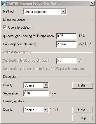

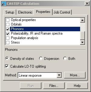

So I check the Phonons in the properties tab,
and change the PHONON_ENERGY_TOL into 2.5e-4, which is higher than 0.230769E-03eV/A**2.
but when I re-run with the Phnons properties, it failed again and the 'Ce38Gd2O79p 245_PhonDOS.castep' shows:

Could anyone tell what I can do to run the raman succefully?
