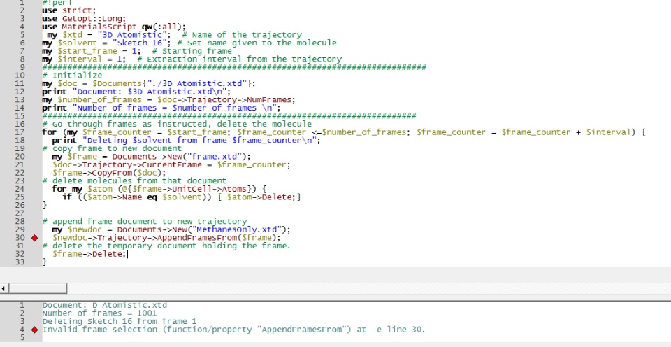

Dear All,
I have written a perl script to create a new xtd  file, loop over each frame, copy the contents  to a temporary document,  delete the atoms that I don't want from the  temporary document and  append it to the new new trajectory and repeat  for all frames,when I check  it syntax, it is OKok.png.
But while running, it has something wrong
How to deal with this problem?
Thanks.
