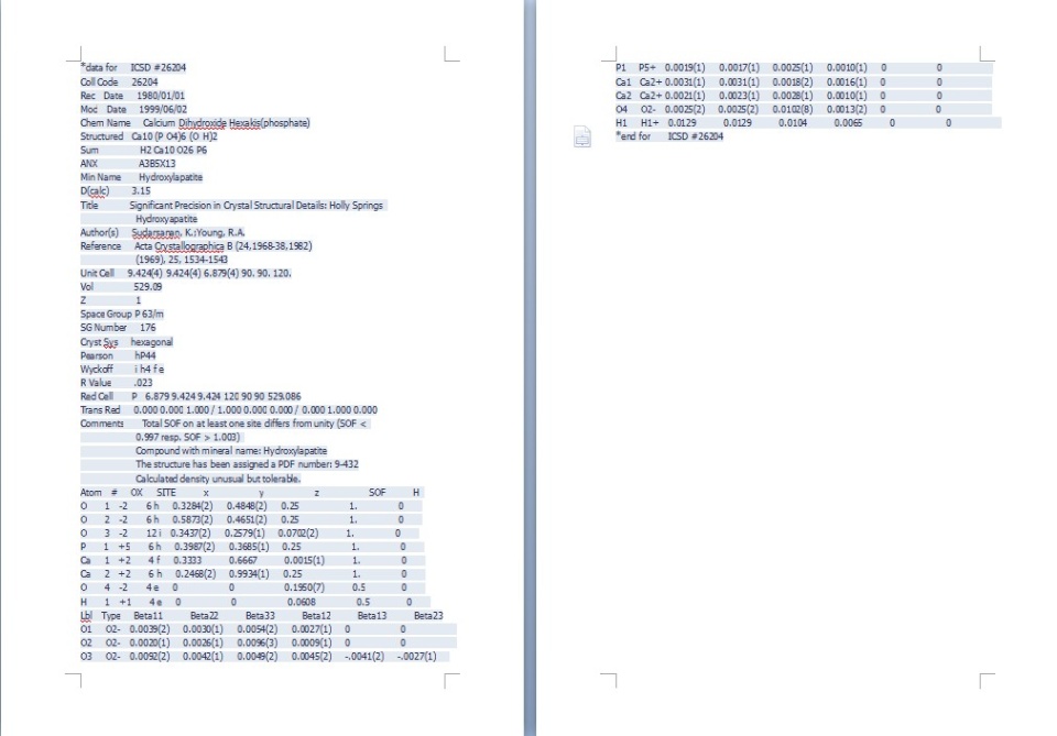

Recently,I encountered a problem in modeling the Hydroxyapatite with MS.I have got the information about Hydroxyapatite crystals from ICSD as follow:
I modeled the Hydroxyapatite crystal by using the lattice parameters and the coordinate. Then I do the Geometry Optimization for the model by using Compass Forcefield .And the charges were assigned by the forcefield. However, after the Ceometry Optimization , the charges of  the model I got was imbalanced.The details of  the charges  was shown in the attachment.
In fact, I hope the phosphate radical have the charge of minus three, the hydroxide radicals have the charge of minus 1.
So, how should I do ?
