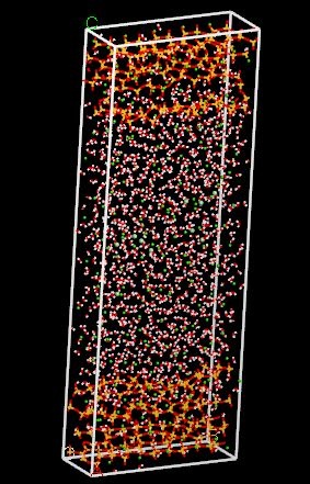

I am woking on simulation of chloride ion diffusion in nanopores of a ceramic crystal. Crystals are placed at top and bottom of supercell. I created a 60 A pore between substrates. Dimensions of my model are 13.38A x 36.95 A x 100.94 A. The pore is filled by 992 water molecules, 10 chloride ions and 5 calcium ions (using adsorption module).
I used COMPASS as forcefield and total simulation time is 2000 ps and summation method for electrostatics and Van der Waals are Ewald and Atom-based, respectively (using Forcite module).
Using trajectory file we calculated mean square displacements (MSD). So, using Einstein formula we can calculate diffusion coefficient. To do this, we exported MSD data to excel to draw diagrams of MSD versus time. The slope of this curve is diffusion coefficient. If we obtain a straight line, the simulation is converged.
But in my simulations, diagram is not a straight line and linear fitting dosen't provide precise approximation for half of the ions. We tested many option to solve this problem such as changing the initial location of atoms (in the middle of sample or uniform distribution in all points of pore height), increasing simulation time, testing another forcefields (like universal, pcff), ....

It sounds like you have done a good job in setting up your model. How far have the ions traveled? For instance, what is the magnitude of MSD (or its square root) after 1ns? Visually you might get a clue by turning off the display of the water molecules and watching the ions to see if they are getting stuck. There may be competing diffusion mechanisms that confound the analysis: bulk vs surface. Can you post the MSD plot?
Thank you for your interest. Actually it is different for different ions. There are 10 chloride ions. MSD after 1ns varies from 100 to 250 A2.
I sent all 10 MSD plots for all 10 ions in attachment.
Morover total MSD of these ions are compared in following image:
As it is shown in figures, there are random fluctuations and we can not export diffusion coefficient. because these lines are not straight.
What is its reason?
Moreover, the solution must be isotropic but diffiusion coefficients are different in three dimensions. I don't know why.
