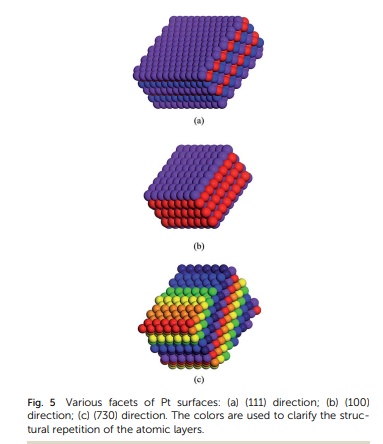

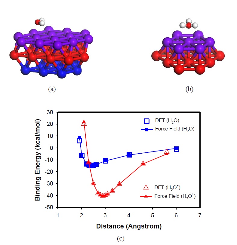

1) First off I intend to build a Pt surface (see first and second image attached)
2) Next, I plan to obtain the interaction potential curve (binbding energy( between Pt and each of the components (water, nafion, graphite). Please see first image attached.

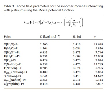

3) I would like to compare the my curve with the optimized potential curve obtained from DFT whose detailed paramters are given in the table attached (3rd attachement).
