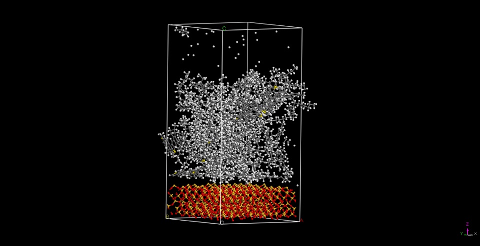

I am using the Build Layer tool in Materials Studio to build a two-layer structure, as shown in the attached Fig. 1.
My question is if the current vacuum layer thickness (+Z direction) is not enough, and I would like to add an additional vacuum slab, how could I realize it?
Besides, whether I can add a vaccum slab in the -Z direction?  Then I could have a symmetric vacuum layer in +Z and -Z direction.
An additional question is about the dynamic run. I built a structure as shown in Fig. 1, and then I did the geometry optimization and a NVT dynamic run for 50ps for equilibrium. In the resulting .xtd file or the last frame. xsd file after dynamic run, I fould some atoms were "absorbed" into the vaccum,  does it make sense, or how could I explain this phenomenon? Because vaccum here is to make sure non-bond interactions from the bottom layer do not influence the top layer (cited from tutorial of Confined Shear), but if I built a three layer system for confined shear task, after the dynamic run, it happened again. Anyone could help me out of this?
Ideas and advice are welcome and greatly appreciated.
Thanks in advance,
Guangji

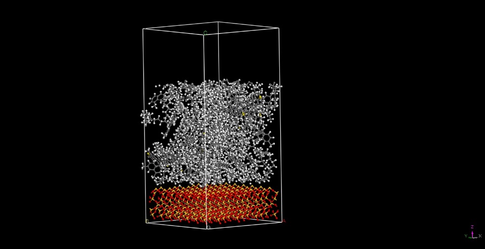

By the way, as for the vacuum absorbs atoms issue, I found that I it may due to the "Cleave" setting in "Build Layer" option.
I built two same two-layer, both with vacuum of 50 Angstrom.
In "Layer Details" in "Build Layer" module , for the the cleave option, one was set to default, and one was set to atomic. After geometry optimization for 5000 iterations,
It is found that there was no vacuum absorbing atoms in default setting, but it took place if I set the cleave to atomic.
May I ask what does "Cleave/Atomic" in "Layer Detail" mean?
Thanks in advance.
Guangji

Hi Guangji,
You can add vacuum to an existing structure using the Layer Builder (again), selecting the existing structure as Layer 1 and specifying the required vacuum length on the Layer Details tab.
If you select Cleave=Atomic it will only take the atoms inside the cell. If any bonds cross the cell boundaries you can end up with incomplete molecules. You can use it for crystals/networks, but for molecular systems it is better to use Cleave=Default, which wil take the atoms inside the cell, and all those connected to it.
