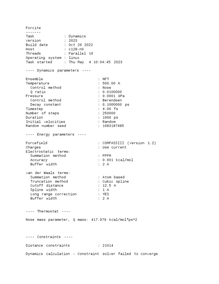

I try to figure out which maximum time step + fix bonds setup I can apply to my polymer molecular dynamics in Forcite. At some point (time step = 4 fs + fix bonds) the calculation set up dies with following error output, std.err: "dynamics calculation - Constraint solver failed to converge (function/property "Compute") at -e line 25.", resp. .txt: "Dynamics calculation - Constraint solver failed to converge". Do you know how to solve this problem? FYI: The xsd-document contains round about 20 000 atoms (a few MMA chains). Is it a too big model for the Constraint solver? Is there any chance for an efficient workaround?
Thanks in advance!
Best regards
Attached you will find:
the set-up of the calculation: .txt
And a picture of the MatStudio log

Hi Nils,
The error means that the Rattle algorithm failed to meet the tolerance for length (1E-4 Å) and/or velocity (1E-6 Å/ps) within the maximum number of iterations (250).
I would check which bonds are fixed at 4 fs (by pressing the Calculate button on the Forcite Dynamics dialog). For example, constraining all bonds in a ring can be difficult to converge.
Also check that multiple time stepping is switched off. You may find that multiple time stepping with a default time step gives better performance than fixing bonds.
Regards,
Reinier

Dear Reinier,
thank you very much for your fast answer and the multiple time stepping hint, it works fine for me!
