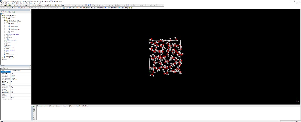

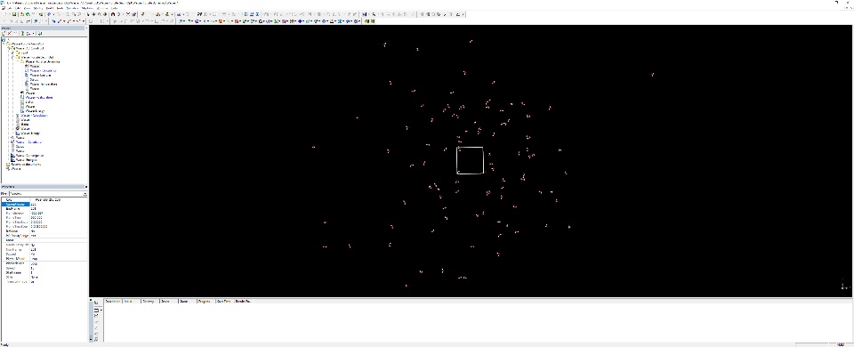

Dear all,

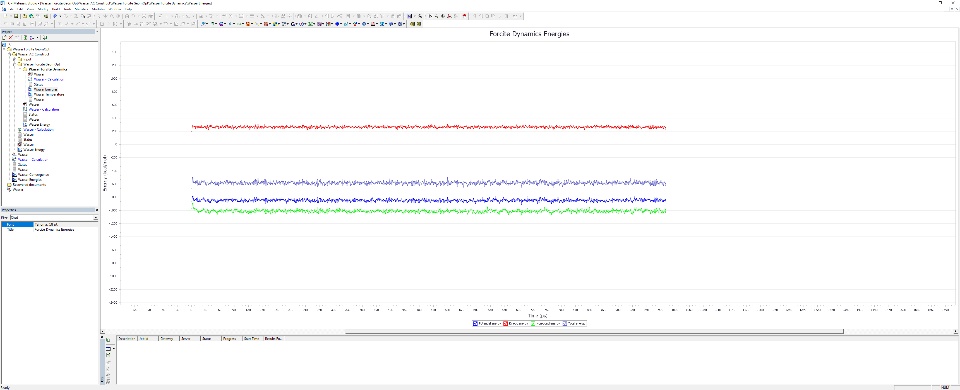

I'm attempting to run NVT on water. The molecules evaporate and leave the simulation cell in spite of negative potential energy of system. Does negative potentials imply attractive forces among molecues?
Please notice the images below displaying frame 1 and last frame, the energy profiles along with the MD paramters. Does this have to do with periodic boundary conditions (that could be missing?)? Where do I find PBC options? Your comments and insights will be highly appreciated.
Many thanks
