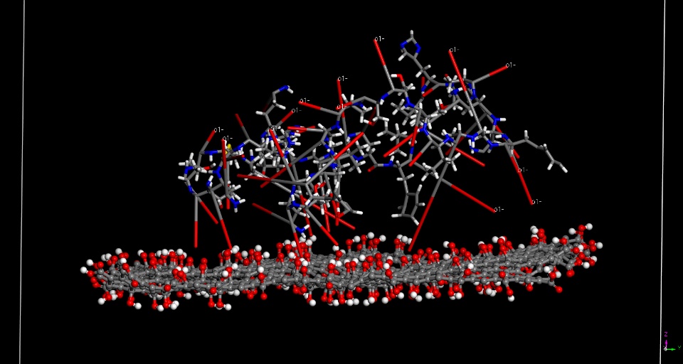

I am currently trying to look at the effects that graphene oxide might have on the amyloidogenic proteins such as amylin.
I've tried to model graphene oxide in Forcite using the COMPASS II force field, and the parameters seems to work fine with the funtional groups present.
However, when I introduce the amylin protein into the system and running geometery optimization, the C-O bonds on my protein started to elongate by an exagerated amount (seen in attachments).
I'm just wondering if this is a bug? Or is it that COMPASS II does not have appropriate parameters for this type of bonds?
Included is an attachment showing the problem I'm having, with all the waters in the cell hiden for better illustration.
Any help will be much appreciated, thanks.

It is unlikely to be a bug. There are two likely reasons. As you say COMPASS II may not be parametrized for this structure. The other reason is that the structure might not be built correctly. I would start by checking that the topology is correct and in particular all the bond types are correct. The next step is to check the report .txt output. If  COMPASSII is not parametrized there will be warnings in the output file. If there is a missing bond parameter then there will only be non bonded interactions used for that bond and the equilibrium distance tends to be longer than valence bond distances.

It turns out that COMPASSII did not assign the correct bond type for that particular C-O bond, it should've been a C=O bond instead of a C-O.
I have corrected this by using automatic bond calculation and I'm now trying to redo a Geometry Optimization to see if it will assign the correct parameter this time.

It turns out that it was because that COMPASS did not automatically assign bond types that caused the missing parameter problem. After using calculate bonds, correct parameters and bond types were able to be assigned and the issue was fix
