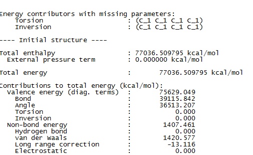

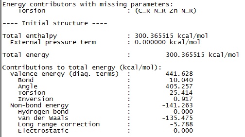

geometry optimization) and select the new force field. When I click to more button, which button should I check? If I press "calculate" and then "assign", I see juct C_1 type (force field) for all the atom and when I optimize the structure (using forcite), I see both inversion and torsion with a high energy. However, if I just press calculate and then click, the force field types are C_R, Zn, etc changing and after optimization I see just torsion term with a low energy. I am confused. Which is true? Could you please tell me the procedure for assiging the new force field that we changed?  Why one of them considers inversion as well?
