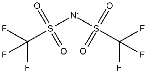

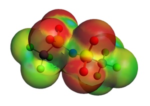

e.g.:
bis((trifluoromethyl)sulfonyl)amide   anion
bis((trifluoromethyl)sulfonyl)amide.png      bis((trifluoromethyl)sulfonyl)amide-cosmotherm.png
                              ADF                                                                           COSMOtherm
                             Materials Studio

Oh, I see. I was displaying something else. This is the ESP field mapped onto the electron density isosurface:
It looks like the same information just opposite in sign. It does seem to make sense that the red part is near the positively charged nitrogen atom. The induces polarization in the solvent medium that is represented by COSMO charges that are opposite in sign. So that seems to be self consistent.

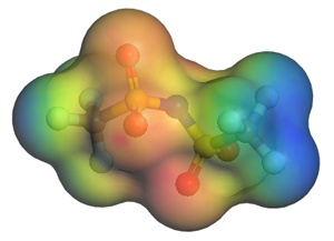

BM
BM 2015-05-08
Now for negative ion, ethylsulfate, the things are worst.
               COSMOtherm                                                                 Materials Studio
Without any fixed and standard scale, at first view to the right image, you think that this ion has positive charge at left side and negative at right side; but it's not true. The left image represents the charge distribution very well.
There should be an option to standardize the color map.
