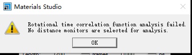

I built a mixture in Amorphous Cell module, with 20 molecule A, 20 molecule B, 30 molecule C and 40 molecule D. Now I want to analyze rotational time correlation function for molecule D in a trajectory file.
I define a set E containing all molecule D in the mixture and conduct rotational time correlation function analysis for it. However, the analysis fails and an error is given as shown in the following figure.

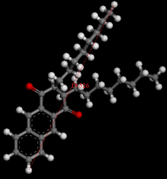

Then I create a distance for molecule D through measure/change tool and use this .xsd file as a pattern document to define a new set F. Rotational time correlation function analysis is then carried out for set F, but the same error occurs.
My question is, what does distance monitor mean and how to create it for a set of molecule D for rotational time correlation function analysis?

Hi Hui Hou, if you select the distance monitor in the pattern document, and then run Find Patterns, it will "copy" the monitor to all the matches in the target document. You can then run Forcite RTCF analysis.
FH
FH 2021-05-21
Hi, you may have to create a set of distance monitors, done the same way as you create sets for atoms.
It is not quite enough to define the monitors themselves, but in addition you'll need to declare that you want to analyze this specific set of monitors and not some others that may be in the document for reasons unrelated to your analysis.

Here is what I did for an atactic polystyrene (DOP 20):
select "Measure/Change>>Distance"
select the two end atoms (of the backbone)
Create a new set (as you'd create a set of atoms), I named it "Distance"
Open "Forcite Analysis" whlie the trajectory doc is active
select RTCF
select Set "Distance" (whatever set name you've given)
change other params ("Length" or "Origin step" as needed)
hit "Analyze"
I ran for 20 frames keeping (Origin step 1 and Legnth 20 frames). I was suprised that it takes quite long than I had expected. Running for 2000 frames would be quite depressing (we have access to CPU calc with MS 2020 license).
