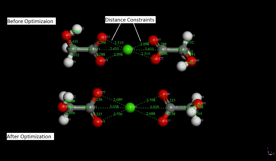

I just want to make calcium glycolate (its a salt of glycolic acid.) and optimized it using Pcff.
I am trrying to create calcium glycolate moleucle in the MS7. I assined dft charges to the molecule and then contrained distance between O- (anion) and Ca++ (cation) [refer the image]. Also, I selected auto force field assigneent and use current charge option.
I am able to see that ditance is fixed before geometry optimization. (There was tick mark in the distance contraint column.) Howvever, after pcff optimzation, distance between calcium ion and oxygen anion got chnage.
How can I constrant the distances? is there another way to make a calcium glycolate molecule ?
Thank you for the help.

Forcite does not support geometric constraints. You can constrain atomic positions or centroid positions. The details about what constraints each module supports is documented under:
Help >> Visualizer Tools >> Constraints >> Support for constraints in Materials Studio
So you might try fixing the positions of some of the atoms. Another thing you could try is using "restraints". These differ in that they apply a harmonic potential to keep things roughly at the same separation distance.
