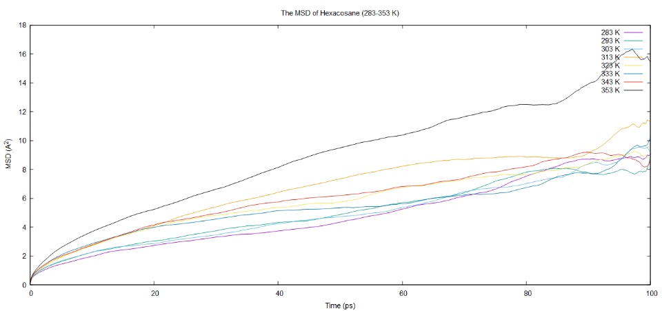

Hello all,
I am trying to calculate the diffusion coefficient (D) from the mean square displacement (MSD) of Hexacosane. I read that D can be obtained from the gradient of MSD. There are some linear trends in a particular temperature of MSD, as in the picture below. Which gradient of MSD actually do I have to focus on? Can anyone help me, please..
Thank you
