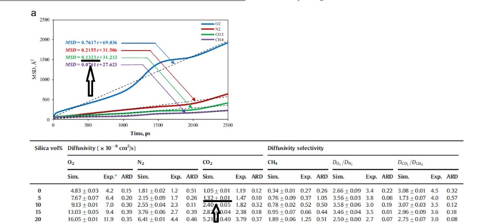

As i know the calculation of diffusion of gas molecules in polymeric membrane is as follows:
D= slop of (MSD vs Time)/6
or
MSD= at+b
D=a/6
Is there another method?
In the attached file (a part of one paper, 2014), as i bold, the calculation is different. The slop for the CO2 is 0.1323 and calculated D is 1.32 * 10^-8. Does any one know how it can be true?
