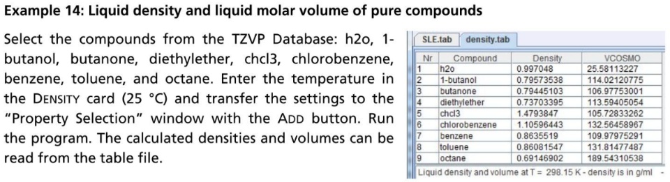

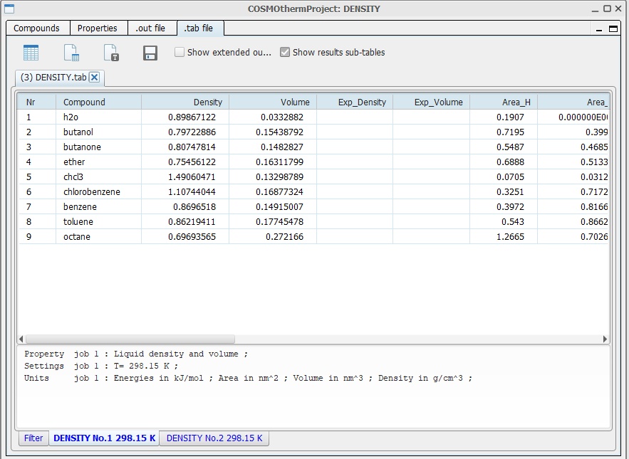

I am trying to predict densities of mixtures of a few compounds with water using COSMOtherm. However, I noticed that the densities that I was obtaining did not match the expected densities of the mixtures. I also tried running some examples from COSMOtherm's "EXAMPLES" folder and found that the densities did not match the ones I found in the COSMOtherm tutorial document (Version C30_1301 - searched online). The tutorial shows the correct value of the density of water (0.997 g/ml at 25C) but I am getting 0.898 g/ml instead. My output and the tutorial's output are attached here. Could someone let me know the reason for this discrepancy? In addition, if someone has the most recent version of the tutorial document, could they share it here?
