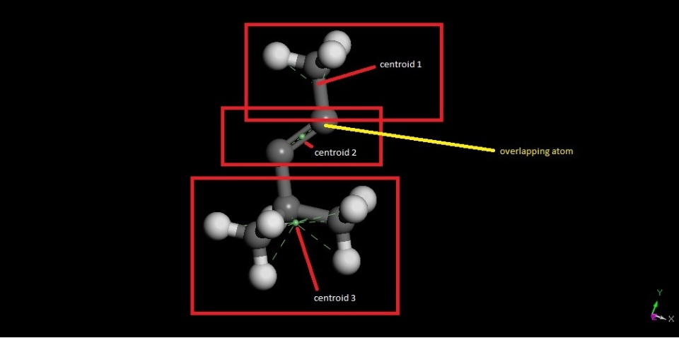

I'm trying to define the centroid of a methyl group from the repeat unit of poly(4-methyl-2-pentyne) but I'm havin trouble getting this to work.
When I tried defining the centroid by grouping the methyl group with the C atom that it is bonded to, this wasn't a problem (indicated as centroid 1 in the attached figure). However, this C atom overlaps when defining the centroid (centroid 2) of the double-bonded C atoms. I'd like to ultimately define 3 different centroids in this monomer, but the undesired overlapping of the C atoms in centroids 1 and 2 is giving me troulble. Is there a reason why Materials Studio does not allow for defining a centroid for only the methyl groups, or am I missing something?
Any help would be appreciated!

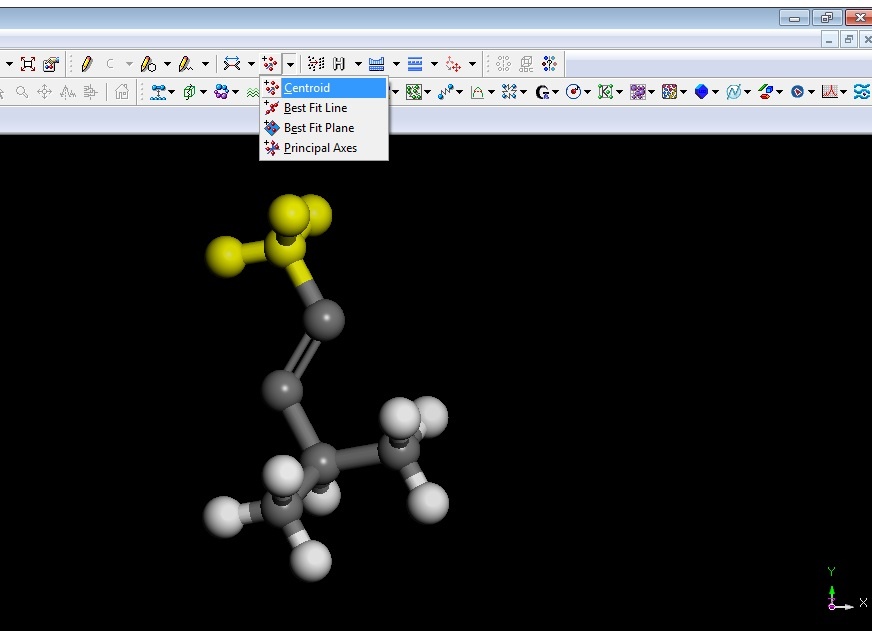

Thank you for the help! The (4-methyl-2-pentyne)_unshared that you attached is the grouping I wanted.
I just realized that why I thought I wasn't able to assign the centroid to the methyl group only -- I had been using the "Ball and stick" atom display style. The centroid was embedded in the "sticks" (bonds) and simply was not visible. Sorry for troubling you with such a silly mistake.

What exactly is giving you trouble? There should be no restriction on the collection of atoms on which to define a centroid.
Attached is a 4-methyl-2-pentyne repeat unit with the centroids defined as in your second picture, with two centroids sharing the same carbon atom. If this is undesired you could define the centroid on the CH3- group instead; I also attach a structure for this case.
