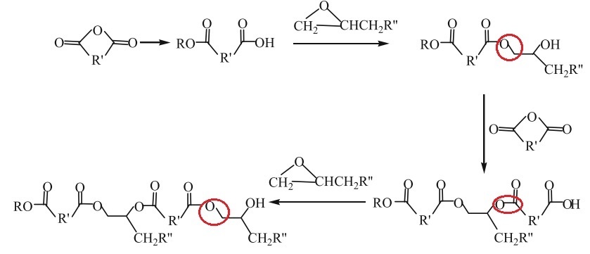

However, I need to simulate a different epoxy system like DGEBF cured by anhydride-based curing agents according to the typical mechanism shown in the attached figure. As can be seen, there are two types of reactive atoms in resin and hardener, so O and C in resin react with C and O in hardener, respectively. Since O-O and C-C bonds between resin and hardener are not allowed to be created, we cannot label both C and O atoms in resin as R1 and in hardener as R2. For this reason I have labeled reactive atoms in resin as O1 and C1 and in hardener as O2 and C2. Now I need to modify the script to measure the close contacts and create bonds between O1-C2 and C1-O2 pairs. I wonder if it is simple to apply such modifications to the script. I would be grateful if anyone can help with this issue.
