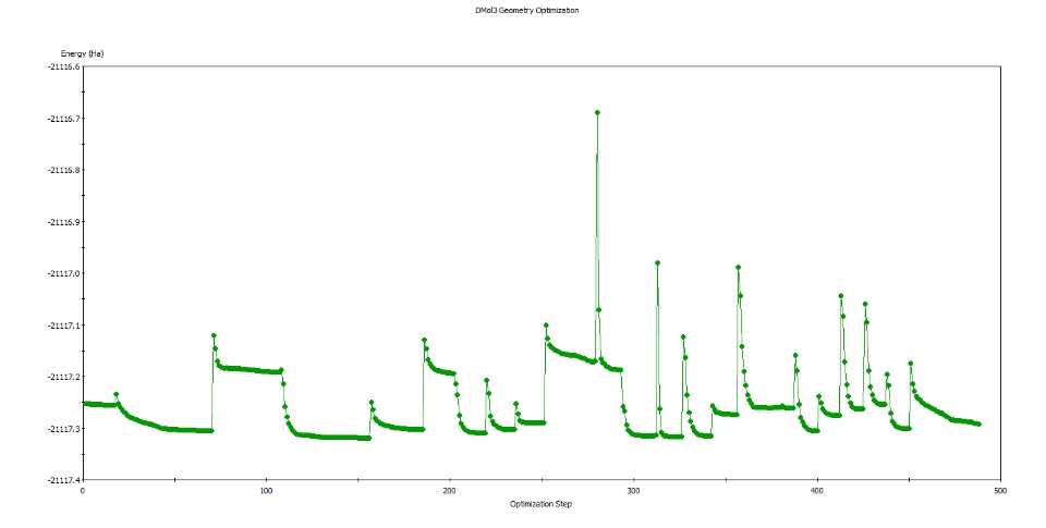

Hello everyone,
I have a question concerning the cell optimisation in DMol3. I am carrying out the optimisation of an inorganic structure. To avoid large "jumps" of some atoms, I have considerably reduced the maximal displacement in the input file, from 0.3 Ang to 0.05 Ang. However, when I carry out the cell optimisation, I still observe rather large changes of the cell parameters (by around 0.5 Ang), and the optimisation shows erratic convergence behaviour. This behaviour is visible quite nicely in the attached energy plot of one of these optimisations. I suspect this is caused by overly large changes in the cell parameters when the optimisation is already be close to the minimum. Is there any possibility to decrease the maximal change in cell parameters from one step to the next, e.g. constrain it to 0.1 Ang?

Hi,
that sounds like quite a serious jump! I checked in the source and unfortunately, I can't help you out on this one - as far as I can tell, there does not seem to be a geometry constraint in the unit cell optimization in the source. I raised a bug report, but can't say anything about if and when this will be fixed. To help with the debugging if and when we do fix the issue, it would be nice if you could send me the input files for your run (if it's not confidential), my email is first dot last at company dot com.
