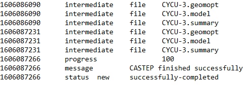

Hi there
I performed a CASTEP geometry optimization and it is found that the calculation was successful as per the status but when I open the output file, it looks like the calculation didn't converge. Any advice will be highly appreciated...
