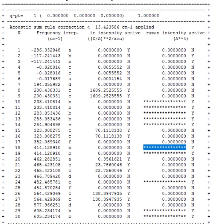

Can you help me?the result of Fe2O3 calculation raman intensity show "**********",use the MS5.0 ...
Can you help me?the result of Fe2O3 calculation raman intensity show "**********",use the MS5.0 .And MS 8.0 also show the same resule

It is the result of Fe2O3 raman calculation,after optimization.

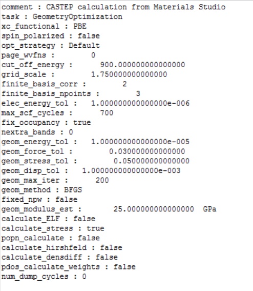

The param of optimizition

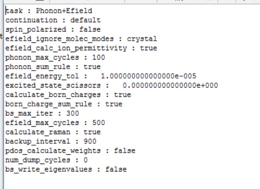

The param of raman calculation
