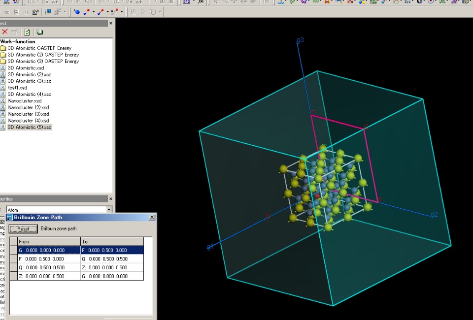

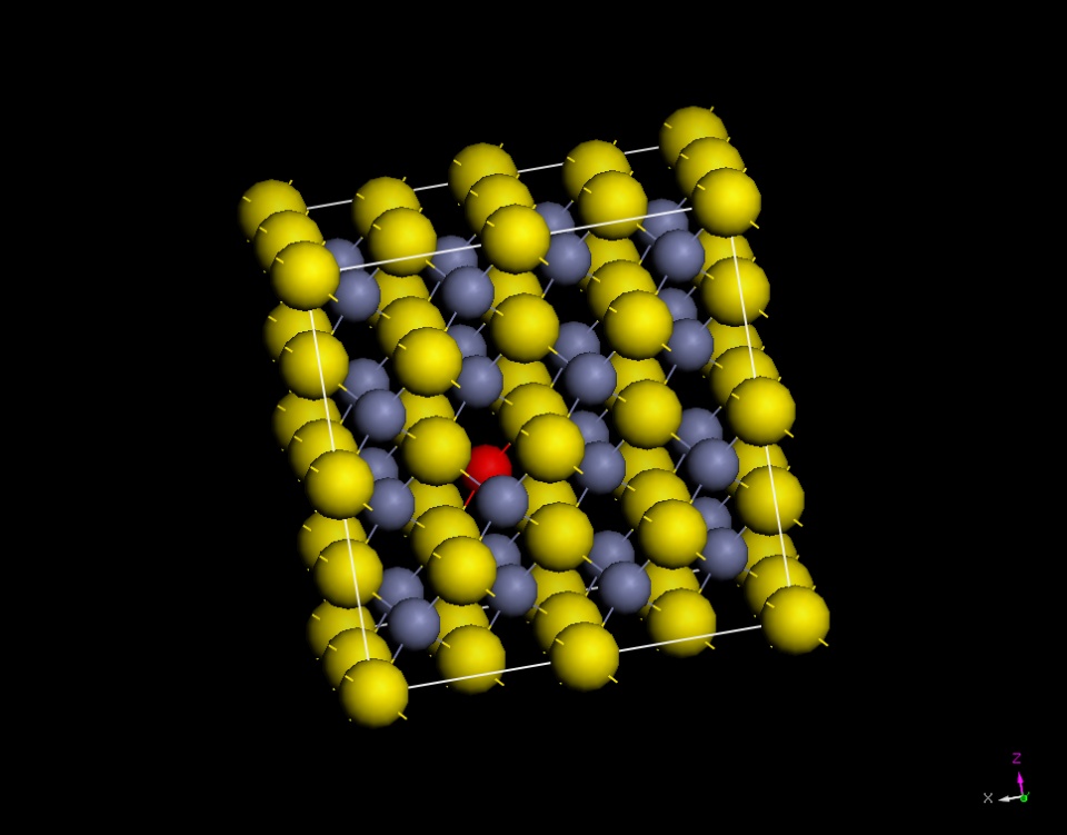

(A):
[Create structure] ==> [Supercell to 2x2x2] ==> [Substitution of Elements]
>> However, the created brillouin zone paths are not equivalent to those of the primitive ones. Also the first brillouin zone is literally cubic.

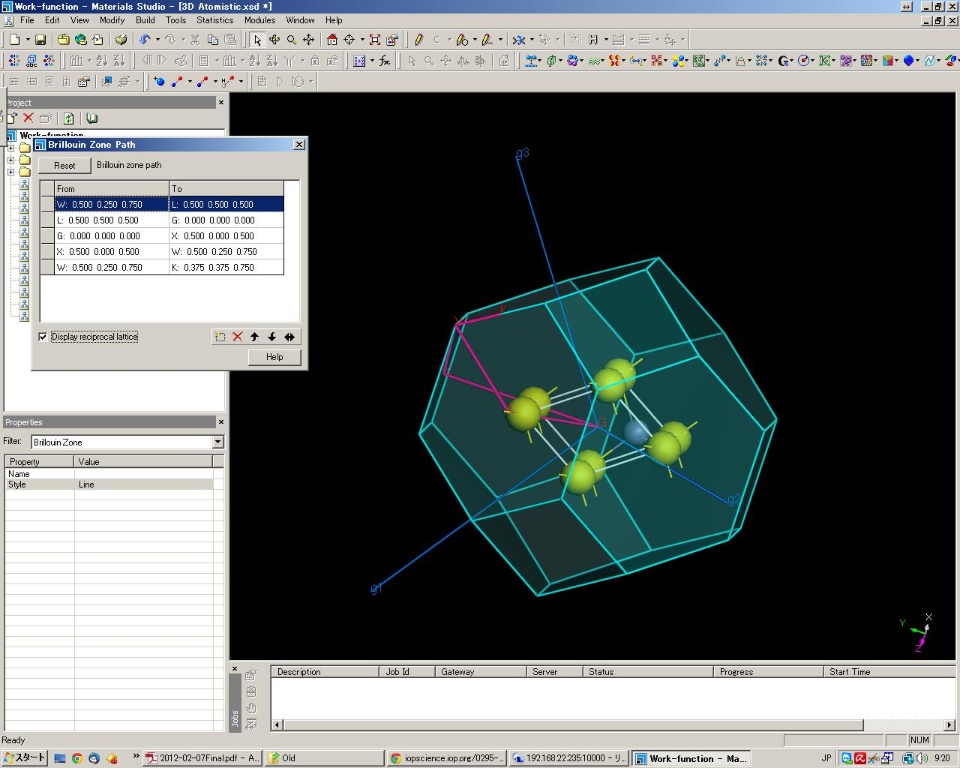

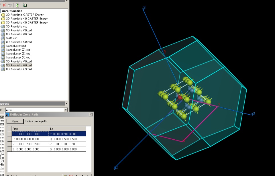

(B)
[Create structure] ==> [Primitive conversion] ==> [Supercell to 2x2x2] ==> [Substitute of Elements]
>> The brillouin zone paths are not identical to those of pure primitive 1x1x1 cell even though the first brillouin zone is consistent to the FCC's.
