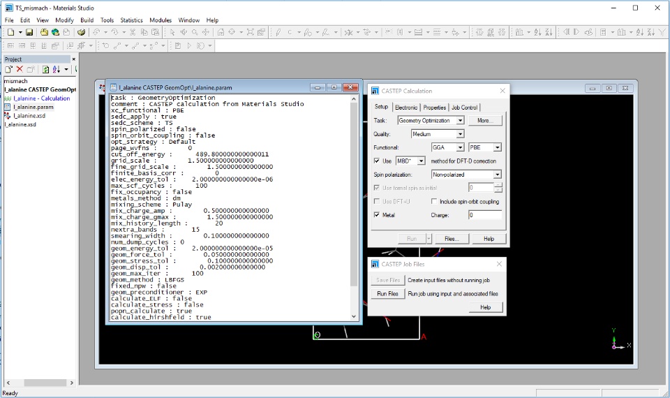

I had find time to reproduce the bug in CASTEP dispersion correction reported in another question. Reproduction:
Set CASTEP calculation (GG PBE) …
Enable dispersion correction and set MBD …
use Files -> Save Files to create CASTEP fiels without lauchnig
Open the .param file
The .parma file will contain TS dispersion correction instead the selected MBD
The buggi state is illustrated on screenshot in attachment.
