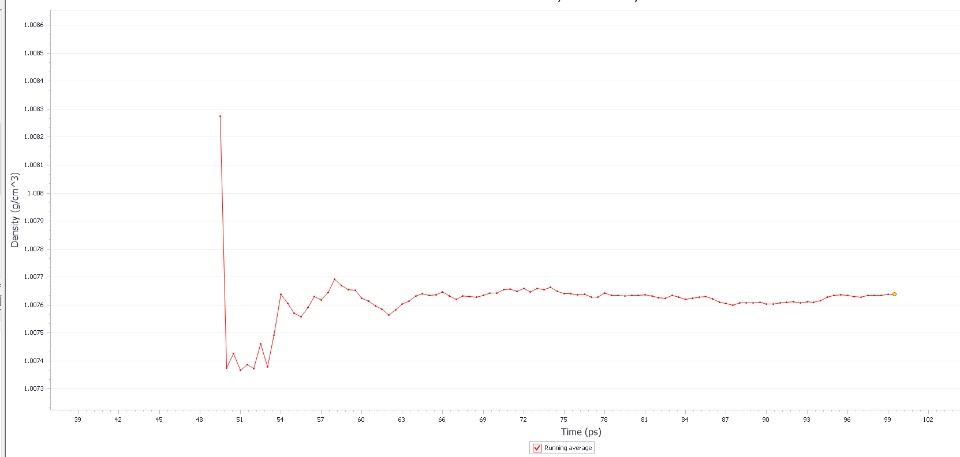

At this point I assumed the 1 ns run isnt long enough to reach the target P and density. So I ran a 5 ns one with the same settings:
5 ns run:
Ensemble : NPT
Temperature : 353.00 K
Control method : Berendsen
Decay constant : 0.1000000 ps
Pressure : 0.0001 GPa
Control method : Parrinello
Cell time constant : 1.0000000 ps
Timestep : 0.50 fs
Number of steps : 10000000
Duration : 5000 ps
Initial velocities : From structure
---- Energy parameters ----
Forcefield : COMPASSIII (Version 1.1)
Charges : Forcefield assigned
Electrostatic terms:
Summation method : Atom based
Truncation method : Cubic spline
Cutoff distance : 15.5 A
Spline width : 1 A
Buffer width : 0.5 A
van der Waals terms:
Spline width : 1 A
Long range correction : YES
---- Dynamics summary ----
Initial Final Average Std. Dev.
Tot. energy (kcal/mol) -12758.154 -13889.254 -13889.147 6.571
Pot. energy (kcal/mol) -13023.643 -14201.297 -14203.812 11.366
Kin. energy (kcal/mol) 265.489 312.043 314.665 10.968
Tot. enthalpy (kcal/mol) -29608.940 -13733.924 -13889.105 2048.672
Temperature (K) 297.881 350.114 353.056 12.306
Pressure (GPa) -39.136 0.364 0.002  4.795
Volume (A^3) 2991.461 2967.901 2968.639 1.330
Density (g/cm^3) 1.000 1.008 1.008  0.000
