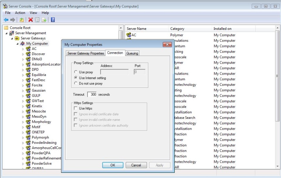

I am trying to run a packing job with the Amorphous Cell tool, but I always get the error of gateway Timeout. However, I have set up my Timeout to 5minutes! (see picture) Isn't it a long enough timeout???

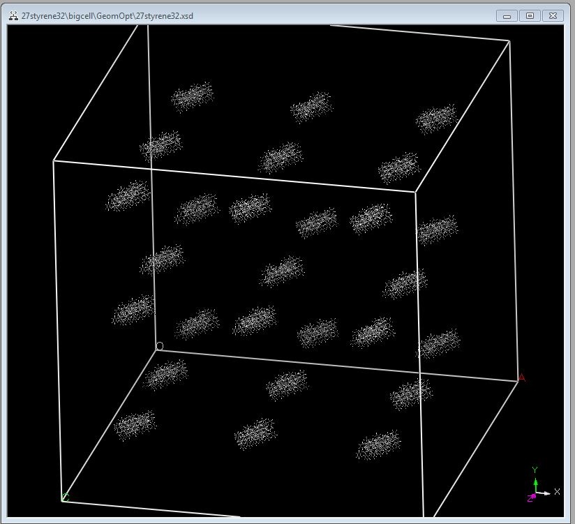

The system is pretty large, a cube of 36nm. However, I am requesting packing to a very small density=0.04gr/cm^3, so finding a final conformation should be fairly easily. Also, I don't request energy evaluations or torsions, to speed things up. Before inserting the solvent molecules (toluene), the initial system consists of 27 polystyrene polymers, each one 32-unit long. Here's a snapshot of the initial coformation:

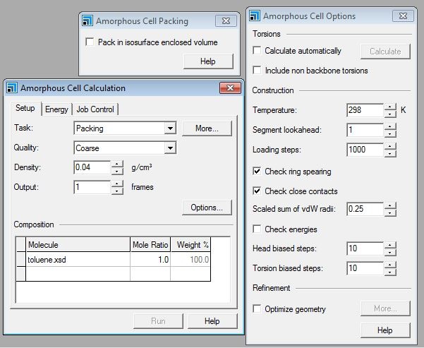

Here's a snapshot of the amorphous cell job specs, in case you can pinpoint something I'm missing:
